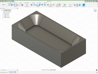

I'm trying to work through how to take a rounded rectangle and "bowl" out the middle like below.
Currently my shape looks like this, but I'm not sure how to hollow out the inside. I've tried pipes, chamfer, etc. Any suggestions?

There are a number of different ways to make this shape. A very common way to attempt this would be to use
extrusion or combine cuts.
Basically what you do is create smaller simpler shapes and use them to literally cut out pieces of material until you get
what you want.
This shape I began with a simple rectangle and extruded it then used the shell command to hollow it out. I then
rounded the corners with fillets and used the chamfer command for the sloped sides.
You then need to draw another sketch using the "floor" of the shape as your plane and do an extrude cut like this.
 Then fillet the edges of that cut.
Now while what I have done is far from perfect, it is close to what you want and it took less than five minutes to knock
up. It helps a great deal if you have the actual measurements and you can get it a bit more exact.

Extrude the hollow block, add fillets to the block
Top section new sketch - offset block outline and Extrude - cut with taper.
Draft the bottom face as desired.
Might help….
