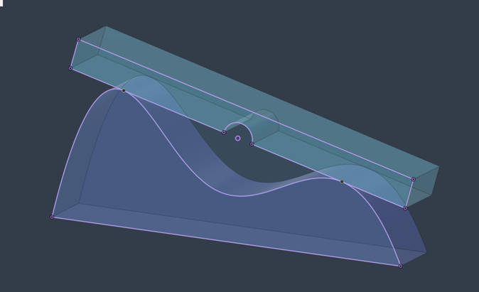

Message 49 of 52
bwalker145
I think I've found a solution that can create a true tangent line between two splines.
Obviously going to be some limitations, and it's a little finicky, but has worked well on the few examples I've tried.
I built a separate component to use as an alignment plate, and constrained it to the spline component via "Tangent Relationship" under Assemble (constrain each face on the alignment plate separately to each spline). Project the components onto a sketch, and constrain a point at the line intersections to define the locations of tangency.
[Edit: Revised method. Breaking projection link not necessary, just add a point with a coincidence constraint between the two lines to find the intersection, and then the new sketch remains parametric.]
