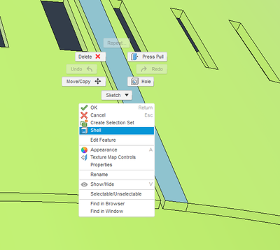

Hi all,
I am trying to flatten/unfold the attached cone, and followed what seems to be the correct process of adding a planar face, but when I try to convert to sheet metal, Fusion keeps giving me an error that it can't calculate body thickness. Can anyone please help me resolve this issue? Thank you very much!

HughesTooling
If you right click this face there's no option to create a sketch which means it's not flat.
I deleted this feature then created an extrude using the opposite face.
And now it converts. See attached file. It will unfold but the flat pattern gives an error, probably because the cutouts are not perpendicular to the face.

Warmingup1953
***EDIT__Correction***
Let me check again...Standby
I fear that body is not conical. Can you share the full file with the sketches(?) that created the "Cone"?
