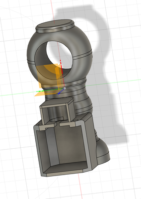

Ive designed a stepper motor housing that i want to "push" into another component which is solid. When i try to do this the part of the solid comp that projects into the housing remains instead of being cut away.
i have made a solid balnk of the housing (tool) which i can use to cut and then insert and  join the hollow housing in the hole but it seems a long winded way around the problem and i cant help but feel im missing something obvious.
is there a way of doing this simply?

Thanks please find attached the file. This is what happens hppens i try to join them, the solid object comes through the hollow one, and i want the hollow component to displace the solid mass

Thanks for taking the time to help. unfortunately thats not what im trying to achieve. I have actually done what i need to do but im certain theres a more efficient way of doing it! what i need to do is insert a hollow object into a solid one so that the hollow object removes the mass of the solid one and replaces the solid mass with a shaped void that i can insert a motor into.
This is what im after, but to do it i had to create a solid component the same shape and dimensions as the hollow one and use it as a tool to cut the main component and then move the hollow component into the void created by the solid one. There must be a simple way of inserting a hollow piece into a solid one!

Hi, I would like to propose 2 methods where you do not need to create a new component. For the sake of simplicity, I have created 2 bodies instead of components. I have also replaced your models with a simple cylinder and a shelled out cuboid.
2 combines
  • Use the combine tool with the cuboid as the cutting tool to cut into the cylinder (target). Check the keep tools option to keep the cuboid.
  • There will be a useless chunk of solid remaining which you can hide or delete.
  • You will need to perform another combine to join the 2 remaining bodies together.
Boundary fill
  • Select both the cylinder and cuboid as tools.
  • When selecting cells, check all cells except for the chunk of cylinder that resides within the cuboid.
  • Set operation to new body and check remove tools.
  • This command combines all the resultant bodies and remove the excess in one step.
I have attached the files here. Hope this helps.
