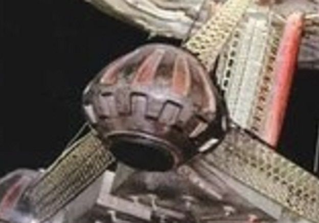

I have started work on creating this spaceship in fusion from a old movie and one of the engines has a very definite pattern around it.
I have created the shape of the engine but I am not sure how to add the pattern around such an unusual shape.
I have attached the fusion file for you to use.
Any help will be greatly appreciated.

Is there a logical reason that you are not making use of obvious symmetry about the Origin?
I was going to demonstrate the technique that I would use - but you have already made this far more complex than needed.
Edit: Yikes.  The first thing I would have done is split this up into two different canvases and centered them at the Origin.
Back in a minute.
See Attached.

I just looked at your solution and kicked myself.
I have cut created sketches and used these to cut bodies and then created a circular pattern using faces plenty of times before.
Such a straightforward solution that I should have known.
Thank you for reminding me of it and sorry for the stupidity on my part for not remembering something I use all the time.
