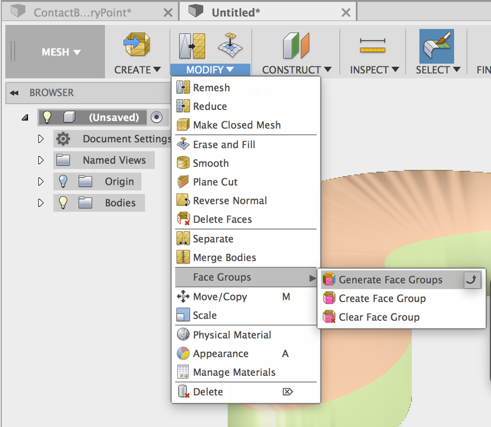

It might also help to try adding Face Groups in the mesh (depending on the mesh of course).
I hope that helps.
