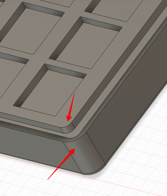

Im newbie in fusion 360. Stuck on this. On some step happened this. Rounded corner on top and bottom part is different. Only one corner, others is fine. I need make bottom corner smaller.

I believe you have a STEP file which you want to change the corner radius.  Use the Press Pull command and enter the value you want.

Press Pull not actually help. I'm attach project to post.

Can you simply Delete the faces and enter new Fillets?
Having said that, I see a lot more issues that if this were my work I would simply recreate proper geometry from scratch.

Here is the reason you're having this issue, you've used the Offset Face tool (shown in the screenshot below in the timeline) and selected that corner alone without the rest of the corners.

one workaround: "delete fillets" and recreate them in the desired size

guys, there is no need for a workaround when the core issue is a misselection, that when fixed the whole thing is working proberly ...
I've noticed that some are suggesting recreating the whole thing when there is no need to!
