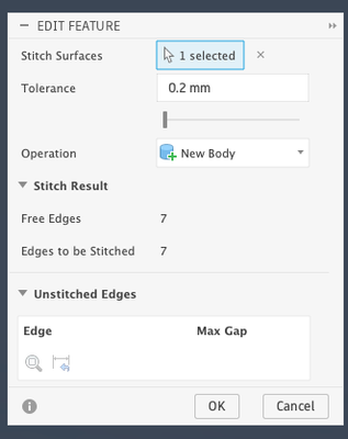

In the end I solved using the "Stitch" function in "Surface" tab with a tolerance of 0.2mm and it became a solid body

That is a V.E.R.Y bad idea for obvious reasons. Fusion's stitch tolerance in the 0.1 mm default already is open like a huge barn door.
I often set it to 0.01mm and sometimes even 0.001 mm (the default in Autodesk Alias, for example).
