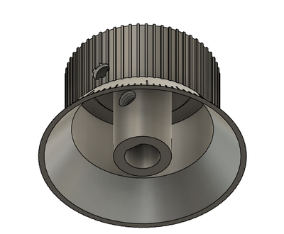

I am a beginner with Fusion outside of simple objects, so if this is easy and I have missed it I apologize.  I am trying to recreate a know that has a skirt (see image).  Around the image there are markings, numbers, text, and a circle.  I would like to add this and emboss or recess it into the skirt, so that after I print it I can add paint in the recessed/embossed area.
Where do I start?  I was able to project a couple of circles onto the skirt, but then couldn't figure out how to actually extrude/recess the area.  Is that the idea though?  Draw everything out on a 2d sketch and then project onto the skirt face?
I did see a bunch of videos on adding text to a cone (essentially my skirt) but in this case the markings/text need to be equally spaced, etc....so I wasn't sure if it would 100% correlate.  Same with videos on adding features to a cone (https://www.youtube.com/watch?v=Z_imovRajhc).  I thought maybe the individual markings could be done this way, but wasn't having much luck after projecting to the surface.
Any help or guidance is appreciated.

Start with a sketch on the XZ or YZ origin plane.  Draw a rectangle the height of the tallest line. Draw another line horizontally at the midpoint of the rectangle.  Draw another line halfway between that and the bottom.  Deboss the bottom quarter profile.  Circular pattern it 100 times.  Deboss the bottom half profile.  Circular pattern that 20 times. Deboss the full profile.  Circular pattern that 10 times.
If you want to 3d print this, create a copy (paste new) of the knob, then combine cut the original from the copy with keep tools enabled.  This will give you the separate bodies for printing in a different color.  The horizontal line can be simply revolved.  The text can be embossed from separate sketches.
p.s. You can use the Suppress option in the circular patterns to remove the duplicate bodies.
