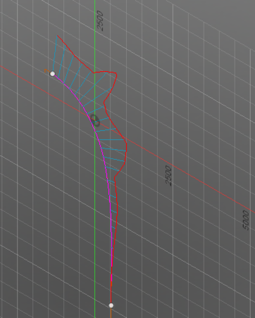

jeff_strater
The main (OK, only) control you have for this is the Spline Fit Tolerance setting.  The default is 0.01mm, and with that level of accuracy, you get very bad results:
however, if I set the tolerance to 10mm instead, I get better curvature:
The curve length of this curve is 6400mm, so a large tolerance is acceptable.  Even at 500mm, I cannot see very much deviation between the mesh section and the resulting curve, and the curvature is much better:
