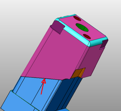

Hi members, i have a small component,
the problem here is that i need to extend the top model to the base model in a straight line or some angle like 1º
i dont want to use loft because it connects the edges.
in powershape i use draft to achieve, but i cant do it fusion
i want to achieve this.

Can you show the modified version from powershape? Do you still want the angled bottom on the base of the top model or do you want it parallel to the top face?
Is this face still angled after extending.

can you make a video? cant understand the steps, but yes, i want to create a top profile and extend in straight line to botton object or plane

i want to extend blue area straight to botton

These fillets are stopping Fusion from being able to move the bottom angled face.
If you can delete them then add back after extending the part Move-Face will work.
Part with fillets removed.
Then extend using Move. Just step along the timeline to see what I've done. No I can't make a video.
File's attached. You just need to add the fillets back.
