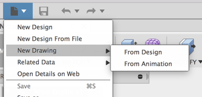

TimeraAutodesk
Hey @Anonymous,
Here's a quick step-by-step of how you can get a basic patent view:
1. Open the design you want to get a drawing of, and then select "New Drawing > From Design" from the file dropdown menu. (Note that you can also create an exploded view in the Animations workspace and create a drawing view from that storyboard as well.)

Message 15 of 18
Dear Timera,
I am trying to follow your instructions with the screen captures, but having no luck. The Fusion 360 I have installed (V 2.0.3803) does not have the features shown on your screen caps, and I am lost. Being a complete newbie, I could really use your help!
Vlad
Message 16 of 18
TimeraAutodesk
Hi @Anonymous,
Can you tell me which step in the process you're struggling with? All of my previous documentation should still be relevant for you to follow.
Timera
Message 17 of 18
Dear Timera,
You are right: everything is correct as you show, it's my .stp file that has problems. I listened to a recent webinar and they showed exactly your methodology.
However, when I follow the instructions, I get a warning: "The design contains neither solid bodies nor sketches. A drawing cannot be created." Is there something I can do to correct this issue? If not, I will ask the people who provided me with the .stp file for precision.
Best wishes,
Vlad
