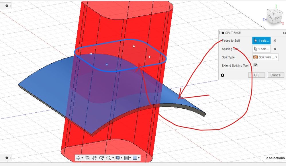

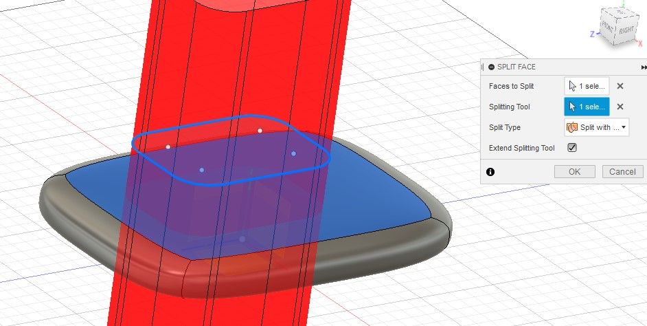

shahriarsifat1802164
For solid bodies you need to make a sketch first, it can be either a surface or a new body having a specific thickness. Then use split body or face>> select the face you want to perform the task and the sketch as a tool. Screenshot 2021-02-15 194246.jpgScreenshot 2021-02-15 194406.jpg
Screenshot 2021-02-15 194610.jpgScreenshot 2021-02-15 194638.jpgScreenshot 2021-02-15 194652.jpg
