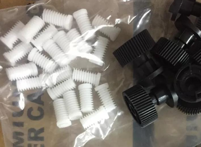

Hello!
I need to model this white screw that works with the black gear.
I was able to model the helical gear and make it work with the partI was given, very worn out as you can seesee in the next picture. I tried making a M9 screw as that was the diameter of the screw and tried the 4 options for Designation and they didn't fit. I think the problem has to do with angles.
How can I draw it? I can tell all the parameters I discovered for the helical gear if that helps.

Reply (1)
chrisplyler
If you know the parameters, search the forum for "custom thread" and you should find the instructions for defining your desired thread.
