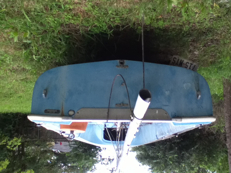

I am in the same place - Front Top and side view of the boat -resulting in a sketch of the shape on three planes - It is the connection of the three views that stymies my limited Fusion knowledge
I set "3D Sketch" to enabled ... and tried to add vertical (z axis) lines of the right height taken from the profile (xz plane )...  but they did not "stick" to the original (xy) sketch ...  The Boat is an old Lone Star 16 that i wanted to modify

I had in mind to modify the existing hull to include a cabin, and wanted to make most of the mistakes on the screen rather in building materials - The term is "Pocket Cruiser " - The Designer has gone the way of the companies that made the boat - and the detail drawings are not in his collection Lone star side.jpg
