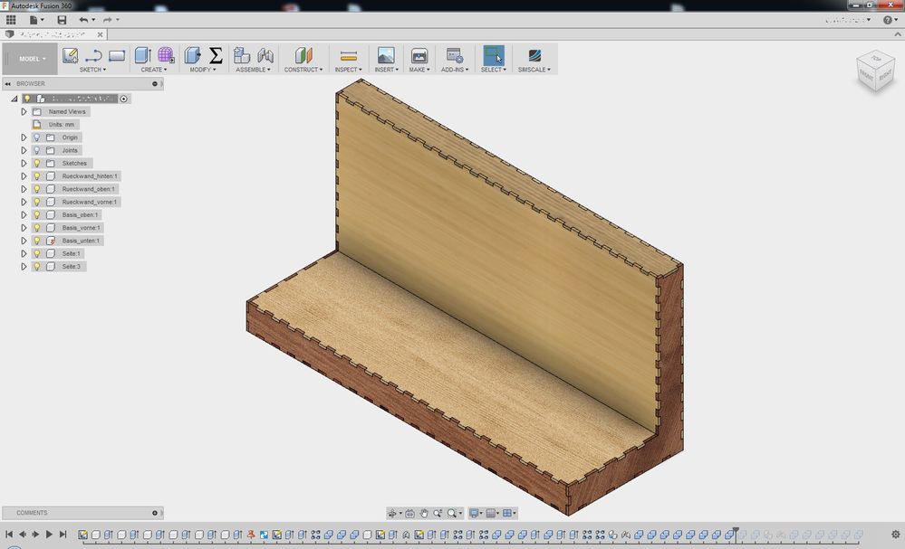

1hdsquad
This is what I came up with, thank you again!
