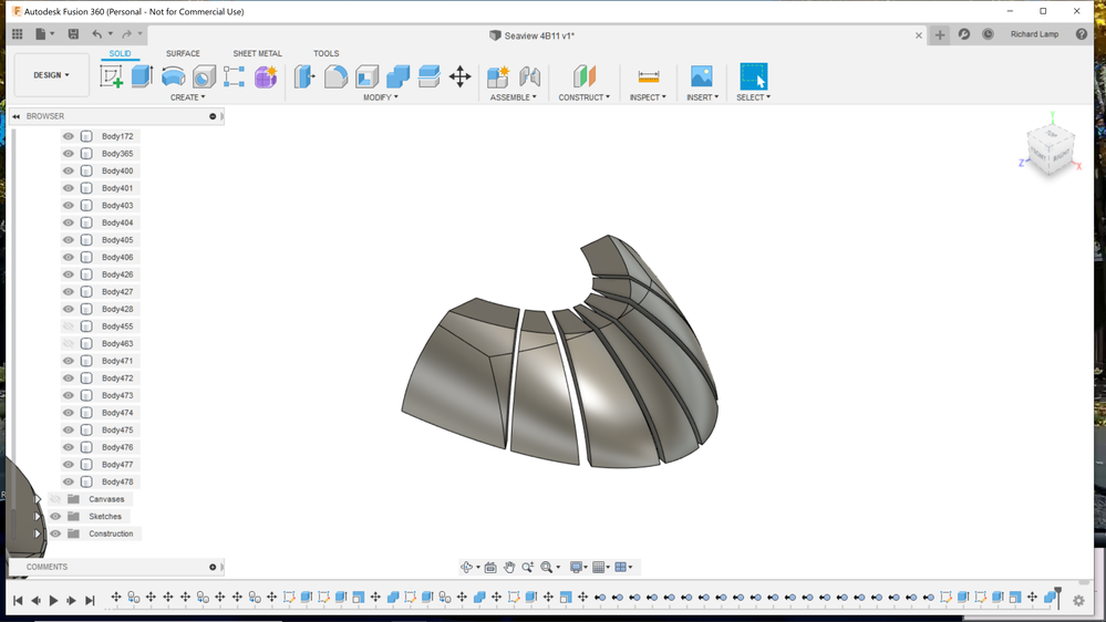

Here is a model that I am re-creating from drawings and need to understand how to model the window openings in the nose of the submarine.  I have tried the techniques described on the net for mapping sketches and solids onto the cylinder but non apply to creating these openings onto the slanted surface of the object that is created for the nose.  Help is appreciated.  I have been at this for several days and no luck.  See the image for ideas.Left Side ViewLeft Side View

Use that sketch you make and extrude surfaces back thru the submarine. Then split the submarine hull with the surfaces.

Try creating your sketch on the bottom instead of the side.  This image using @laughingcreek's file shows how to he was able to keep the sides straight when using the split face command.

This final area of this model/design messed with my head, and thanks to all the suggestions on here and some thinking on my part, I came up with the solution that eventually worked....thanks to all.
The steps to the success are as follows
1.)     Copied the nose cone as a separate body
2.)     Created a offset plane at the rear section of the nose cone (to act as the pivot area for the following steps)
3.)     Created bodies at the pivot plane to act as cutters into the nose (see pictures)
4.)     Eyeballed the degree of angle to achieve the windows I envisioned
5.)     Cut the nose cone at the top and bottom to achieve the desired window height
6.)     Scaled the angled body cutters so as the whole height of the nose cone would be encompassed
7.)     Removed the non-essential bodies that would not be windows
8.)    Cut the nose cone with the remaining window bodies
9.)    Removed the original nose cone and replaced it with the cut nose cone
10.)   Enjoyed the fruits of your and my labors, Thanks to all!Created bodies around nose coneCreated bodies around nose coneCut top and bottom of nose cone to size of desired windowsCut top and bottom of nose cone to size of desired windowsScaled bodies larger than height of nose coneScaled bodies larger than height of nose coneScreenshot (47).pngCut nose cone with bodiesCut nose cone with bodiesAfter cutAfter cutRemoved unwanted bodiesRemoved unwanted bodiesCut nose cone with window bodies and placed nose cone back in placeCut nose cone with window bodies and placed nose cone back in place
Message 11 of 15
etfrench
Looks good.  You could simplify your workflow a bit by using a sketch with a continuous line (zigzag) as the splitting tool instead of creating individual bodies.
