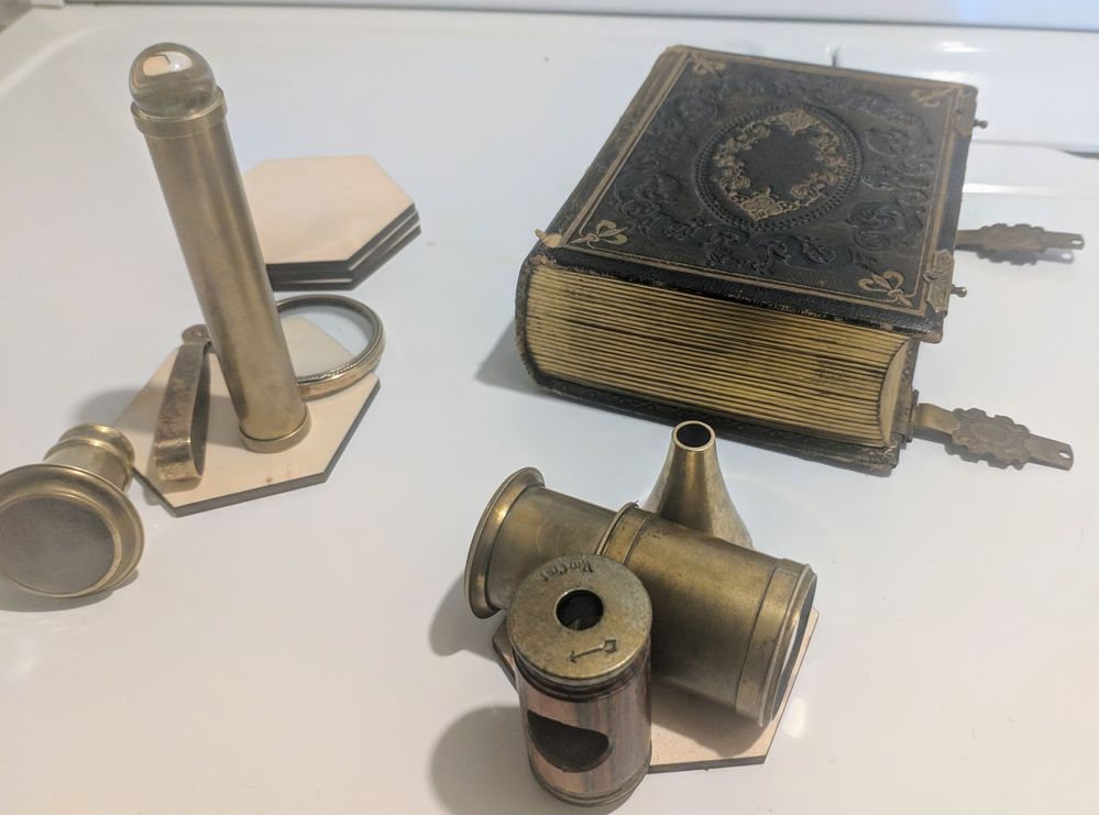

     So I'm attempting to design a 3D drawing/model (pages w/o cover) that within it has the multiple voids for the shapes of objects that I hope to find a home within the book. The attachments should make this clearer.   I wish to use Slicer to be able to layout the pages where the voids will be for using our laser cutter using 1/5" luann to mimic the pages of the book and create the necessary spaces on each one..

Here in the attach I had started this project by doing one 'page' at a time
but never found the way to stitch the pages all together...
Am i correct in trying to remove the space these items would otherwise
consume?
