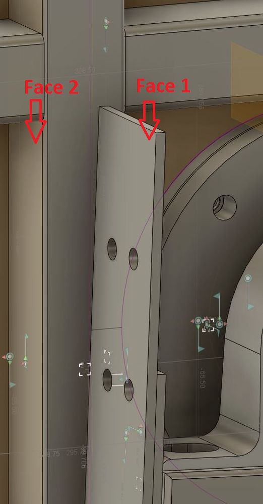

Hi Fellow Designers,
How to create a parallel joint in Fusion 360 between two faces?  I want to make a parallel joint between face 1 and face 2 as shown in the picture.
Thanks in advance for providing the solution.

How do the two faces move relative to each other on X, Y, and Z planes?
ETFrench
Message 3 of 9
AgileJohns1411
Thanks for the prompt response, they translate in Z-axis and XY plane should be parallel
Message 4 of 9
jhackney1972
You did not supply your model so I created a simple model of the area you are looking at.  I created a "Joint Origin" between the two faces on the center of the plate but you can use any point to locate it, even a sketch point will work if needed.  I then used another component and matched up two joint origins to show how it is used to get a planar joint. Take a look at the screencast.

If the moving Component only needs to translate in a single direction, a Slider Joint is more appropriate than a Planar Joint.

HI jhackney1972,
Thanks a lot for the solution, it was pristine and to the point. I am sorry for not providing the models and will ensure to attach them in future.
