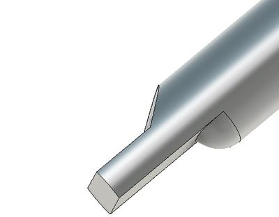

I have sketched three line segments that are coincident at two points, and used the fillet command at the points of coincidence and at the endpoints.  I used the sweep command to create a rod; that is, I sketched a circle perpendicular to the path formed by the segments and "swept".  The circle/OD of the rod is 7 mm.
I created another body that looks like a tab.  One face of it is a rectangle 7 mm long by 2.54 mm wide.  I moved this body to the end of the rod so that the 7 mm face touches the 7 mm diameter of the rod (center point to center point).  See the screenshot.
I'd like to "cut" the rod, flatten it, so that the tab and the rod are flush.  If I describe the tab as having 2 (large) faces and 4 edge-faces, then I want to flatten or cut the rod so that it is flush with one of the two (large) faces.  On the opposite face of the tab, I want the rod to round down to it like a fillet I guess.
The edge-faces of the tab I'd like to "round" to the same diameter as the rod so that it meets the rod perfectly.
The tab and rod I'm trying to make one piece if that makes sense.
I've tried creating planes and the sweeping those planes with "cut" selected but nothing happens.
Any suggestions?

Like this?

Very close.  For one the edge-faces, yes.  In my picture there are three edge-faces showing (and one facing/touching the rod).  The three exposed edge-faces should be rounded exactly like you have in your pic, but your pic only shows two edge-faces rounded (the outside one is still perpendicular to the faces of the tab.
For the faces either side of the ones in your pic will suffice:  either the rod sloped down to the tab or else the rod rounded to the tab.  How did you do that?
But one of the faces of the tab needs to effectively continue and cut the rod so the rod gets flush with it.

The straight side is just a two direction chamfer.  The rounded side is just a fillet.
Mark up your image with a red pen to show which faces need to do what.  It would also help if you attach your file to the thread: File|Export|Archive file *.f3d.

Attached are some attempts to convey what I want.  Attached is the f3d too.
The fillet command isn't working.  It may be because it's not seeing the two bodies as one.

Fillet only works on single bodies, so you need to join them first.
Is this what you wanted to do:

That looks perfect.  I used the techniques to duplicate the results on the other side.

I added a tapped hole to each tab, and now I'm ready to have it made in aluminum.  I believe I need to convert this to a 2D drawing now.  New thread I guess.
