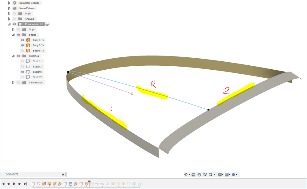

davebYYPCU
Will this help, side view 1, top view 2 and front view rail R.
Using Alex's file, adopted to what I was saying.
Don't need sketch 7.
Because we are not using the sketches, for 1 and 2, the option for Tangency becomes available when you use the edge of the grey bodies....
Might help.....
