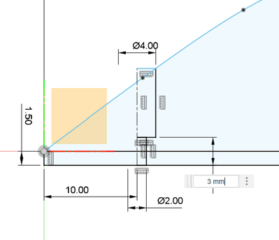

I've created a solid with a flat bottom and curved top.  I've created two holes, starting from the bottom flat surface and extending up through the top curved surface.  I now want to counterbore at the top surface so that screw heads will have a flat seating when inserted from above.  I've attempted to do this by creating a larger-diameter hole from the top surface down a few mm, but I can't figure out how to center and align the new hole on the existing hole.  Whenever I click on the exising hole to reference it, the new hole alignment either goes into the side of the existing hole, or perpendicular to the curved surface.  Any ideas, please?

Without the model, this is a guess.  Create a construction plane over the curved surface and the hole coming through.  Create a sketch on it and project the hole center, from the far flat side, to the plane.  Sketch your cbore circle on the center and Extrude.  Example model attached.

Revolve works
Extrude Offset works

Not needed.  Simply Offset from the original sketch.

Your Sketch2 is not needed.
Example to follow in a few minutes - check back...
@abennxxx
Edit dimensions as needed in my example (you might want to change my offset distance to 1.5 - I was not sure of your true Design Intent of the Counterbore depth).
In my example I demonstrate a Revolve method and an Extrude - Offset method.
Go through the Timeline step-by-step and examine each sketch and feature...

Ahhh. I saw the 'offset' option in the hole menu, but I couldn't figure how to apply it.  That seems to me to be the most straightforward to me.  I can see how your 'revolve' solution works too, except I can't see how the stepped sketch that you've revolved gets there in the first place.  I'll save your example and replace your revolved counterbore with an offset one for that hole.

Thank you for the tutorial. Rather than modifying your example, I've now modified my original model to give me the required counterbores using the 'extrude' method you demonstrated. As with most things it's easy when you know how!
