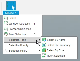

when i try to select a sketch to copy instead of a window dragging across the sketch i get a free form line. what setting do i have wrong?
Message 87 of 94
etfrench
Fusion 360 randomly changes the selection type at odd times.  You just need to reset it to Window Select.
ETFrench
Message 88 of 94
Phil.E
What seems random is actually by design. The selection styles all have default hotkeys. 1, 2, or 3. What might have happened is you pressed "2" or "3" when a command was not running, and that activated the other selection style.
To avoid: Edit the hotkeys for selection styles, remove the number, leave it blank, and it will never happen again.
While you are on the selection menu, check out some other cool selection tools:

It also changes when no keys have been pressed.  Unfortunately, I don't have the repro steps other than I noticed it while dragging a control point spline around.
ETFrench
Message 90 of 94
Phil.E
Normally a UI interaction like actively dragging an object should never change selection style. Some commands have defaults that are specific for the command, or workspace. Mesh is a good example. Paint selection is default in mesh modeling because it's a common expectation and very handy in that setting. But it should not "stick" after you are done with mesh.
