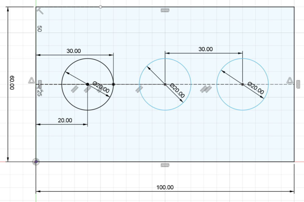

I am coming from Tinkercad so sorry for the silly questions.  One question I have is, I have a rectangle 76.2 mm wide, the center is 38.1.  I place a point on that and make my circle 17.01 mm in diameter.  I want to space out another 17.01 mm circle on either side of the center circle and evenly spaced from the edge of the rectangle.  It should be somewhere around where I have the red dotted circle but i'm not sure how to get that dimension.  Is there a good spacing calculator online?  I basically want 3 circles to be spaced evening across the top of the rectangle.  76.2mm divided by 4 spaces between the circles give me 19.05mm which is in the drawing below but you can see the circle is not evenly spaced.  I'm missing something simple.

You'll use sketch dimensions and constraints.
I deleted the screencast as it did not address the problem.
The math you are using will space the the center points of your circles evenly, but it does not create even spacing between the outside of the rectangle and between the circles 😉

Attached is a design file that does what you describe:
I created three user parameters, which I use in formulas. :
This is the formula which positions the first circle in the sketch:
I could have patterned the circels in the sketch, but usually we discourage users from patterning in a sketch and favor patterning features:
So another formula is in the pattern UI in the timelinne:
This conveys the design intent you described and works for any rectangle size with any number of circles.

etfrench
You can use construction lines with equal constraints (as well as a few horizontal/vertical and coincident constraints).
Or you can use a formula in a rectangular pattern: (Width of rectangle - (circle count * diameter))/4 + diameter

The reason these formulas a bit more complicated is that they can be used as a generic case. The design requirement - even spacing between the sides of the rectangle and the circumference of the circles - will always be met, regardless of the size of the rectangle, the diameter of the circles and the number of circles. attached.
If you only need three circles, you  don't need user parameters and can achieve the same thing with sketch tools e.g. construction lines and constraints. I have an example attached. However, the first, seemingly  more complicated approach does a much better job at capturing design intend.

Okay, thank you all.  I will have to dig in a bit more tonight when I get home and look this all over.  Just to be clear the equation to find this example where to place 3 circles with a diameter of 20 mm equally along a rectangle that is 100mm would be this?
(rectangle_length-(num_circles*circle_diameter))/(num_circles + 1) + (circle_diameter/2)
(100-(3*20))/(3+1) + (20/2) = 20
OR THIS
(100-(3+20))/4+20 = 30

In this formula, (Width of rectangle - (circle count * diameter))/4 + diameter, 4 refers to the number of spaces between the circles and the rectangle.  It is always be equal to the number of circles plus one.

You need to create those user parameters.  Open the parameters dialog clicking on the Modify/Change Parameters menu item.
Add the parameters and set their values in the dialog:

I think using construction lines with the equals constraint to be more obvious than using a formula.  The nice thing about the formula method is that it can be used in a sketch or on the solid model.

(Width of rectangle - (circle count * diameter))/(num_circles + 1) + diameter
(100-(3*20))/4+20 = 30
Now with my answer being 30, the first step is to place the back edge of the first circle 30mm from the 1st edge (or 20 mm from the 1st edge to center of 1st circle) then after that point I can go from center to center on the circles with 30?  Just making sure I understand the process.

Unfortunately, doing that way is not parametric.  Observe what happens when you change one of the dimensions in that sketch.  Equal constraints on construction lines between each circle and the rectangle will always be correct no matter which dimension is changed.
