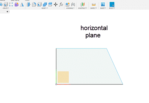

I have a horizontal face.
I want to create a sketch vertical to that face.
Any easy ways?

Just select a perpendicular plane from the origin or offset a plane from the origin.
g-andresen
if you don´t want an origin plane create your own from the 1. sketch.
create vertical plane from sketchcreate vertical plane from sketch

if the various easy ways don't work, then you can create a "axis perpendicular to a point" on the face, and then create a "plane at an angle" on the axis
