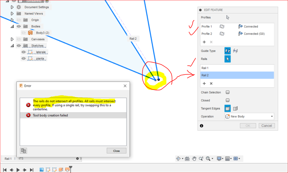

motorimicro
please a little help ... I ran exactly the same commands to draw my own surf fin but I still have problems with the loft, could someone help me if I'm wrong somewhere or could it be the different shape of my split lines?
Message 14 of 27
davebYYPCU
Laterale sketch is bad.  Line is not attached to origin.
Tangent handles here must be vertical,
Then no error.
might help.....

motorimicro
I have done many tests but I continue to have problems.
unfortunately editing the loft that I am copying however it is not clear if the profiles are the split lines or a point while for the guide it is clearer.
I am attaching my file again so if you want you can check if I have correctly set the vertical handles and if you can maybe kindly indicate precisely profile 1 profile 2 and the rails so I will try again. thank you very much
Message 16 of 27
davebYYPCU
Laterale Sketch still bad,
straight line must be horizontal.
Profile is not touching Rail 2.  Everything else is OK.
When making the loft, profile and pick spline point, hide sketch, use body edge rails off the extruded body.
When you fix Laterale sketch, extruded body will update.
For Loft, must be accurate sketches.
Might help.

motorimicro
i often have this kind of problem with fusion and i think that is a bug because i do the correct thing...i use project include intersect but don't work, i spend a lot of time but don't work iand i don't know how to resolve...always the same and i read other post with person with same problem ...i don't know
Message 18 of 27
davebYYPCU
Your Ok for sketch Pianta,
Project is working ok.  When you fix sketch 1, sketch 2 is working.
Your straight line was not on the Origin, when you fixed that end, the other end was not horizontal.
Can not project for 1st sketch,
must have straight black or purple lines, (except spline)
Rails not touching error -  always correct
Might help....
Message 19 of 27
motorimicro
thank you a lot the real problem was thet line was not on the origin.
i was exasperate.
