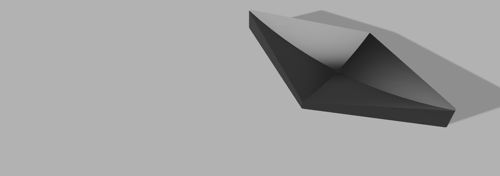

Message 12 of 17
SaeedHamza
Here is a screenshot that shows that you need a fillet ( in the black areas ) in order to get something smooth like this
Saeed Hamza

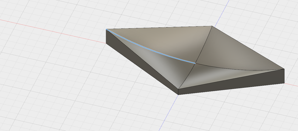

ernkla
Message 16 of 17
SaeedHamza
Check this, it  will help you do it
Saeed Hamza
