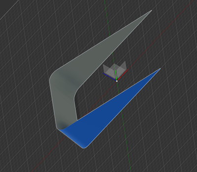

how would you suggest to create a voronoi pattern along a curved surface like this one?
I'm struggling with the tools I know. I kinda wish I could flat that surface, Apply the voronoi, extrude it and curve it back (loft? sweep?).
260 Views
TrippyLighting
You can!
Create a sheet metal part bent as in your screenshot.
Unfold it.
Apply the Voronoi pattern.
Refold.
Done!

It doesn’t let me create a sheet metal body out of that surface though. It says the surface need to be flat. 😕

In the project there are the surface body, and a solid thickened from the surface. I tried with both.
TrippyLighting
Your design is already pretty broken, but I'm showing you the fix anyway.

That's amazing.
I never would've guessed.
I was trying to achieve the same result starting from a straight sheet of metal and then bending, but the measures were way off.
Many thanks for the help 🙏
