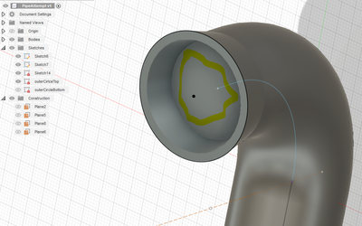

I'm trying to get a pipe to loft up to a slightly larger diameter for a shop vac..but no matter what I try I can't get it to work? It just give an error "The loft could not be created. Try changing profiles for rails or center line or adjusting continuity conditions." (Which I don't really understand!)
How can I get two different pipe diameters to join? Thanks for any clues!

Message 2 of 17
davebYYPCU
Use outside circles for solid loft.
Use inside circles for an inside cut loft.
You need another sketch on the end of the pipe, or solid pipe and shell after the loft.
Loft can not do donuts in one go.

g-andresen
In solid mode, lofting of hollowed bodies is not possible. In this case, you must project the profile on a sketch on the pipe and then first loft the outer profile and then the inner profile with the CUT option.

matthewpolack
Thank you I really appreciate the replies...but I'm struggling to get this to work. I'm having difficult getting the loft command to work. I'm doing something wrong. Here is step by step what I try:
1) I click on the open end of the pipe..and I create an Offset plane.
2) I click on this plane..and then create a centre circle.
3) I highlight the new circle sketch at the end of the pipe...a completely solid circle.....exit the sketch...then click on the larger circle about 10mm above. Again just a solid circle.
4) I choose "Loft"
5) The loft command does not work as I'm used to...it just doesn't connect. It looks like this picture. Thank you..I really don't understand why this doesn't work?

matthewpolack
Ok..this is absolutely weird...I've just drawn two circles above each other..I choose Loft...and nothing happens..but there is a loft in the timeline. Interestingly there is a centre dot that I don't normally see. Can anyone figure out what is going on? Here is the current project:
https://a360.co/3bmDe3D
Screenshot of the loft that isn't a loft!
Edit: I actually just recreated a blank pipe in another file...and this worked well..so something somehow has become corrupted in that main project that blocks lofting! Really strange.

davebYYPCU
Turn off your Section Analysis.
Ask me how I know. (Check my pic, above)

TheCADWhisperer
@matthewpolack wrote:
...inside this particular project the loft feature appears broken! (Or I've somehow destroyed lofting ability!)
Whenever you get unexpected behavior - you should Attach this new file here.
The geometry is there.
Tip: Rather than attempting to Loft pipes - model as solid and use Shell instead.
BTW - where are your dimensions? Blue sketches should keep you awake at night.
And this could have been done with Revolve rather than Loft.

matthewpolack
Thanks so much. I've been working for a couple of hours on trying to get this to work! I ended up trying the strategy mentioned above which was to loft cut...but this wouldn't work to cut! (The "Ok" button is greyed out.) Looks like maybe I should have tried a different strategy like shell or revolve? Thanks so much for the help...I'm really struggling with how to do this...what is the best method...and there is just so much I don't understand...but will keep trying! Thank you.

davebYYPCU
In your pic, message 8 top section of the Dialogue Box, there is only one profile listed, Loft requires 2 or more profiles.  That pic also does not show an internal circle on the pipe face, so selecting the pipe face may not have been accepted.
So at that stage you have a solid elbow (not shelled or hollow yet), adding a solid Loft does not need a sketch on the elbow face, but adding a cut Loft does need the internal diameter at the solid face to be identified, and selectable.
To save the grief, a solid pipe, then solid Loft joined, then shell both end faces, (preferred and ) is the easiest to understand.
However if the article in Message 7 is the end game, then I would do that with hollow sweep, with a Path / Guide rail.

davebYYPCU
Actually the sweep scales the wall thickness if done with donut profile, so back to Shell.
(Modified Whisperer's file for this demo - so pipe and intermediate sketch stuff, are not strictly required.)
Dimensions are required to fully constrain some sketches.
Might help....
