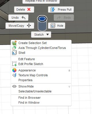

j9lemmon
Thanks @g-andresen but "Find in Timeline" was not on the context menu when I right-clicked the Hole.
Screenshot:F360-missingFindInTimeline-Screenshot (216).jpg
laughingcreek
discover-ability is one of my gripes about fusion, but I digress.
if you squint you can see 3 hash marks over the features when you highlight the face of the hole-
