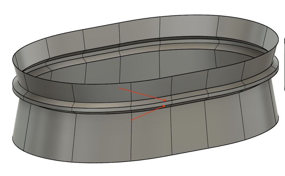

So I have made a start on the hand and following your screen cast.
Now, I am stuck on your the first part.
I create the five levels as you did, changed to the box display and indented two of the faces and then tried turning it back to the smooth display. Whilst the rest of the body smooths the crease we are making stays squared.
I am obviously missing something.
Help is definitely needed.
Regards
Ian
Message 12 of 23
TrippyLighting
It looks like you creased too many edges. Uncrease these two:
Message 13 of 23
