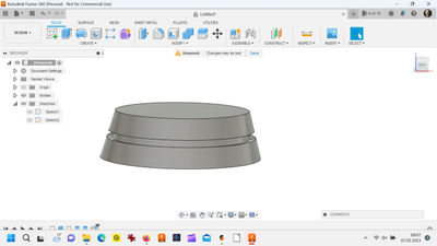

I created an extrusion from a sketch. I have the following requirements:
  1. I need to cut a 3mm deep channel in the extrusion
  2. The channel needs to run all the way around the extrusion
  3. The channel needs to be centered between the top/sketch face and bottom sides
What is the best way to accomplish this task?
Should I split the body and create a narrower body or component between the top half and bottom half and join them? Or is there a more desirable or eloquent or preferred way to accomplish this?

try this way

Oh my goodness thank you so very much. This is an awesome video. I’m out cycling and I cannot wait to get home and do this again I can’t thank you enough.

You can also try another way.
Draw a sketch on a midplane with offset
Then cut out the ring by extruding

In addition, there is a method that could be interesting for bodies that are not cylindrical.
Here you can apply Offset Face.
The surface must first be split. For this you can use a sketch.
Split Face
Offset Face
