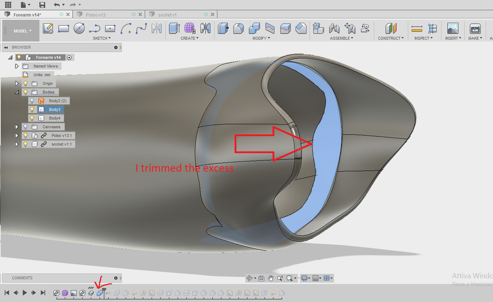

I'm modelling a forearm and a socket for a prosthetic project. How can I merge these two bodies with a more regular edge? The green dashed line is the desired edge.

That is hard to say from the distance. Can you invite me to the project so I can open it here or show more screenshots?

I see what you try to do
buil the t spline model as needed
but then trim the two parts with a gab you can fill via a loft blend surface
