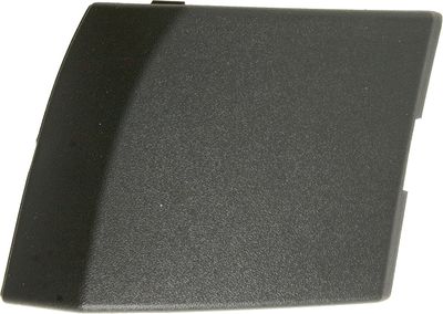

Hello. I'm new at using Fusion and Cad Drwaing. I've watched some tutorials and started drawing a part I need but I cannot understand how should I design a specific part of it.
As attachment you can find the original part photo.
This is what I've done and I think I have to extrude and rotate the sketched blue part, but it seems to me this is not possibile and has to be done in other ways, any suggestions?

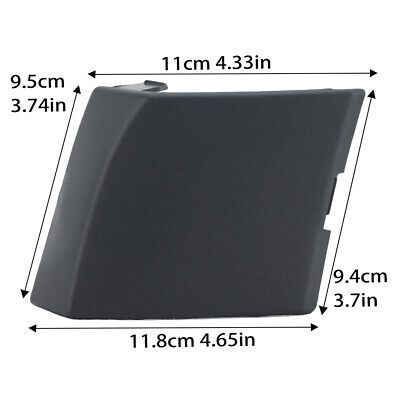

Hello. This are the pictures I have:
I wanted first to make a draft and 3d print it, then to make the "final product"

The good news is that you have everything you need to model this. I would start
by taking a front, side and top view of the item and starting a new project and
use these images as a Canvas on each axis. Once inserted as a Canvas you then
need to Calibrate the canvas so that the image is the correct dimensions.
Use the calibrated canvas to create an accurate sketch of each side. Literally
trace the edges. This will give you a basic shape of the item and some "rails"
along the edges. Then use the Sweep or Loft command in the Surface tools.
This would give you the basic shape including the curves. Add a few flanges
and thicken the whole thing up and its done.

Hi! This particular part can be made more easily with Surface Modeling workflow. Instead of creating a solid body right away, you may create a patch surface (delete the extrusion and use Patch command to create the patch surface). Then use Ruled Surface command to protrude the left edges to a distance at an angle. Stitch the surfaces together. Use Thicken command to solidify the surface body. Lastly, round off the edges.
