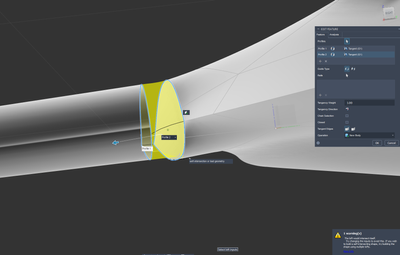

Hello all,
I want to join this wing to the fuselage smoothly. Since I cannot match the forms body exactly to the wing airfoil I somehow need to make a transition. I tried to fit it as well as I could but of course it will never match exactly.
What's a good way to join/blend them together?
Also in the process of unwelding the crease of the fuselage I created two NGons. I don't know how to fix that if that needs fixing at all. Shelling the fuselage fails as "sharp shell" and takes quite long with the "rounded shell" option though.

I just did some minor changes to the fuselage forms body and now the loft isn't working anymore with G1 tangency. G0 works but that does not look good of course. It's always intersecting itself in a weird way (see image) and I can't figure out why. @TrippyLighting can you maybe take another look? I'd appreciate it so much!

The loft needs more "breathing room" so I trimmed away more of the wing. I also extruded a bit more of the T-Splines toward the wing and removed the crease on one edge so the profile is round. I split the wing surface into two halves and lofted each separately. I would not touch this anymore as edits will get trickier as the model progresses.
The Wing/Fuselage transition is very tricky to model!
