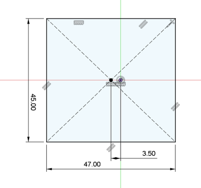

Hi @TheCADWhisperer, so when I create the rectangle that defines the hole ("small rectangle") in the die part, it is staying blue so I cannot get the larger sketch to extrude with a hole in it.  I tried adding  parallel constraints to the small rectangle but it errors saying the sketch is over-constrained. What am I doing wrong?  Updated file attached.
Edit:  I updated the sketch to have the same constraints you have in your screenshot but it still remains blue:
Clarification on what you mentioned above:
1. It was unclear to me if you wanted symmetrical about the top and bottom and only shifted to the side or if you also want shifted top to bottom of the rectangle relative to the rectangular hole...
==>It does need to be shifted both top to bottom, and side to side.  The arbor press I'll be using apparently was not made with everything properly aligned 😕
Message 25 of 51
TheCADWhisperer
@Fab_Things
You appeared to have taken wrong turn at first sentence in Message 19.
This should be a Centerpoint Rectangle at the Origin.
Also you created this third rectangle in Sketch2 where my instructions were Edit Sketch1 and add it to Sketch1.
I think you are jumping ahead and getting confused by the forth rectangle (for the offset center).
Us my step-by-step instructions to finish it my way - and then we can go back and make any edits necessary to get it exactly matching your true Design Intent (editing after the fact is trivially easy when robust modeling techniques are used).

Fab_Things
"Now sketch another 2-Point Rectangle at the Origin (be careful not to click on the construction lines of the previous rectangle..."
@TheCADWhisperer  How do I sketch a 2-point rectangle that is centered on the origin? (I know how to do one using a center rectangle but, not a 2-point one).
Message 30 of 51
Fab_Things
Attached is the finished design following your step-by-step instructions, with the exception of Msg #19: "Now sketch another 2-Point Rectangle at the Origin"  While awaiting when you have the chance to reply to Msg #29, I used a center-point rectangle for the one in Msg #19 - it has the dotted diagonal lines like yours so I hope that is acceptable.  If not, please explain how I can center a 2-point rectangle on the origin like you did as I do not see a midpoint constraint in your file.

TheCADWhisperer
@Fab_Things
Carefully examine the dimensions in the attached image (Especially the red dimensions).
Tell me what dimensions you want to change and what they should read (you might have to do some calculations considering the edges I used as datums).
