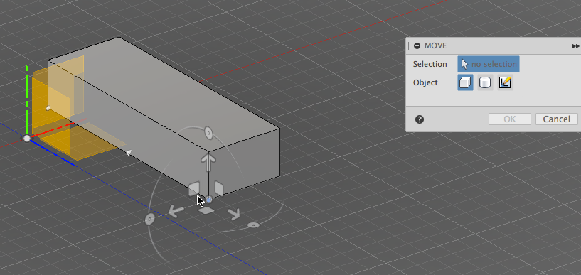

2. For existing bodies/components: Use the move command. You can select bodies or components.
In this example I move a box to the origin.
Move command.
Select components filter, it's the box on the left. The default is bodies which is the cylinder you see selected below.
Pick a pivot point.
If you need, set the pivot again.
Or just use point to point.
The other corner and the origin are selected.
Done. Because the component moved, we should accept the Snapshot.
