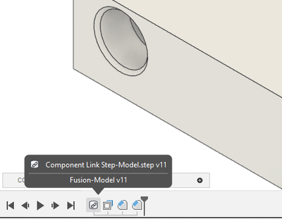

Hello everyone
I'm exporting the Fusion-Model file, which is linked to the Step-Model.step file.
I'm uploading the Fusion-Model file again, but the linked Step-Model.step file is missing.
Is there a way that the linked step-file is not lost when exporting and uploading?

@etfrench  wrote:
It's not a step file once it's been loaded into Fusion 360.
The "Step-Model.step" file is truly a Step-file and not a Translation to Fusion and was uploaded into the Cloud with AnyCad. The "Fusion-Model" file is linking the "Step-Model.step" file.
After exporting and uploading the "Fusion-Model" file, the link to the "Step-Model.step" file is lost.

@TrippyLightingwrote:
If the current version of your design would actually include a linked component of the STEP file, it would show up in the browser with a chain link symbol. However, it doesn't!
In my Example the "Fusion-Model" file is linking the "Step-Model.step" file.
I used the method described in this video.
https://youtu.be/DnY0QLHsQiM?t=1140
Mfg
Christoph

So I did check with the Fusion 360 team what the difference is between the two workflows. Th workflow you (and Jason Lichtman) are using allows to modify the imported "foreign"  geometry, where as using a linked component would require you yo make changes to the source geometry in the native application.
Yes, I had the same experience.
If I insert the AnyCad-file into a new file as an X-Ref component, I need to either create a new component with "Boundary Fill" or create a derived component in a new file with "Derive" in order to be able to change the geometry.
