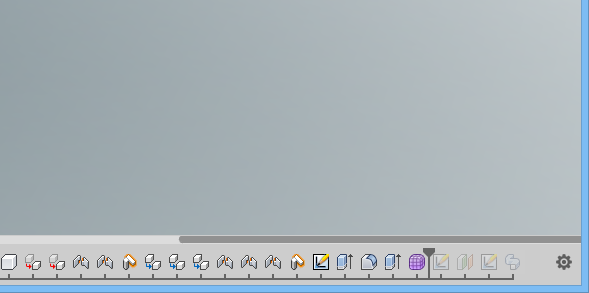

The title pretty much covers it. As I'm working the marker for where I am in the timeline keeps going missing on me. If I shrink my window from full screen it will come back, but i have a big screen and I have it to take advantage of the real estate.
The monitor is 2560 x 1440. I'm running Win8.1 viva bootcamp on a 15" macbook pro with Nvida graphics.

To be clear, are you saying that this is always the result when you are in full screen?
I need to report this, can you use the graphics diagnostic tool and post the results here? (it's in the ?Help menu)

If I have the Data Panel open I can still see the marker, if I close the panel, the marker will disappear. It doesn't like the timeline extending so far across the bottom of the screen.
Here is the Diagnostic:

Thanks this sounds easy to repeat with the right hardware and sufficiently long timeline.
Logged as a bug now. [internal reference FUS-26303].

I am sorry to explain that behavior again and again.
It has nothing todo with fullscreen or not!!!!!
This behavior occurs if you have a large screen (imac 27") and a long timeline that needs to be scrolled on that big screen.
Go to a imac27" open a project with a long timeline resize the window to have the full screen used and close the data-panel.
Then move to the end of your timeline. No history marker!!
So activate the data-panel again and the history marker comes back.
AND, that have nothing to do with the data-panel IT IS a problem with the SCREEN SIZE. You can test to resize the fusion window and
you will see that if you have a smaller window it will have a history marker.
I HOPE I NEVER HAVE TO EXPLAiN THAT BUG AGAIN!

Count me in! Funny enough, it kinda happened at the time when history timeline became wider than fusion360 window. When history marker went out of focus it just got lost. Scrolling did not help either, simply was not there anymore.

Still happening for me as soon as I get a longer History and scale the window to a width of roughly 2300px or more. Quite consistent and easy to reproduce.
