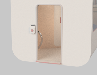

A body that is hidden is showing up in the render. While not being visible in the actual workspace, when rendering, the object still shows up in the image. It wouldnt be a problem if that object wasnt linked to other components of the model, Ive tried moving and deleting the ogject, but the way it interacts with other components, makes them also get deleted. error 1.JPG

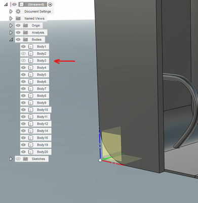

These are the hidden bodies, in the workspace, they are hidden, as they should. But then when rendering they for some reason i dont understand, show up. As you can see the texture is all wonky. The hidden bodies are the first attempts at making the final structure that has teh wonky texture which means i cant delete or move the body, or the final structure gets the same treatment.
Im lost here, really dont know what to do other than redo the entire structure, which i would rather not have to do.

The only relevant body close to the origin that is also hidden is "body3".  If I start a render everything looks OK, and I don't see any artifacts.

I believe what you seeing is simply the result of he completely lack of organization in your project!
INthe rear section, visible through the door is a body:
baño/lact (1)
This is a copy (hence the name + (1)) of baño/lact:
Then you have another BAÑO v1 inserted as a linked component:
All of these occupy more or less the same space. If you hide 2 of the three you won't be seeing them in the render.
Lesson learned: A bit of project organization goes a long, long way 😉

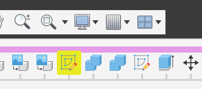

You violated one of Fusion 360/s timeline dependencies.
It then provided you with a warning:
 and colored the respective icon in the timeline:
You chose not to respond to that and continued in your design process.
You should have immediately addressed that error!
