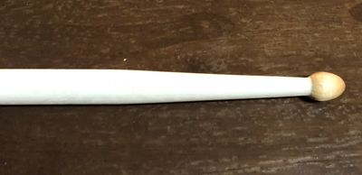

Hello, can some one post a video modeling out the specs on this drumstick. I’m new to fusion and I’m working on this project with my percussion students. Thanks
Drumstick Specs:
Length: 17.1 inches
Diameter: .72 inches
Shaft: 12 inches
Taper: 4.25 inches
Neck at Bead: .39 inches
Bead length: .85 inches
Bead Diameter: .62 inches
Bead Shape: Taj Mahal
