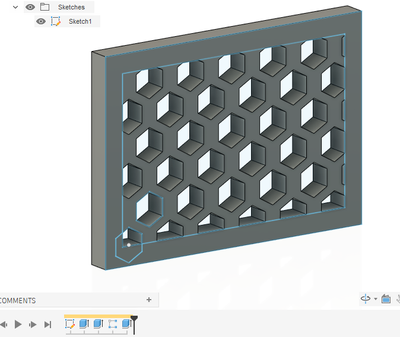

Sure - I want to create a honeycomb grid for ventilation. For this I want to create a boolean difference between the grey hexagons and the blue body. For this I need to select all bodies from the pattern. When I change the parameters of the pattern, create more hexagons, I have to change the difference operation to also include the new hexagons. This does not allow for automatic adjusting without manual intervention. I the pattern (grey objects) would create a single body it would work.

I just showed a fully parametric honeycomb pattern from a single Rectangular Pattern Feature.
Enter any desired value (make it based on a formula if desired).

I've attached an example to illustrate what I want to achieve. It probably uses a similar technique to what you did. Is there a way to automatically adjust the grid if you increase the width or height in the user parameters?

@guardian_de
The Attached example should give you some ideas.
You would have to add a parameter to make the number of instances vary by the Width and Height by integer values.
The trick is setting the Axis orientations and overbuild (as though you are cutting your desired size from a large sheet of screen).
