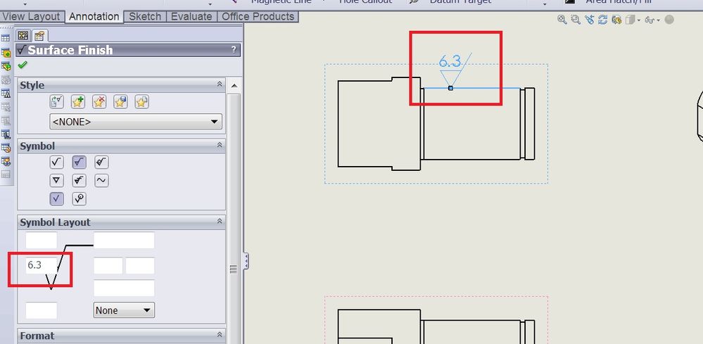

I want to have 3 function in 2D drawings:      the photo from SD works
break and Coordinate dimension
surface finish : I can't enter number in fusion360
