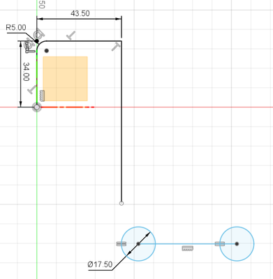

Now start a New Sketch on the XY plane
and sketch a vertical line from the origin and dimension as shown.
Message 8 of 43
TheCADWhisperer
Now sketch a Horizontal line and dimension as shown.
As we proceed, we are not sketching the entire boundary - as we will use Thin Feature to create thickness.
Now add a R5 Fillet to this corner.

Now sketch by eyeball a horizontal line between the two circles as shown...
Wow!  Isn't this CAD stuff easy?
I'll bet you can guess the next step...
Sketch 2 circles at the ends of the line. Add dimension to one of the circles and add Equal (=) constraint between the circles.
