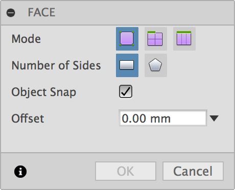

There are a couple of ways to model geometry around a mesh body in Fusion 360. I think the best way for you to achieve what you want is to use the Create > Face command.
Once you've activated it, make sure you check the Object Snapoption in the command dialog box. This will allow you to create faces right on top of the mesh body. You can also give it a offset distance if you don't want the face directly touching the mesh body.
let me know if this helps.
