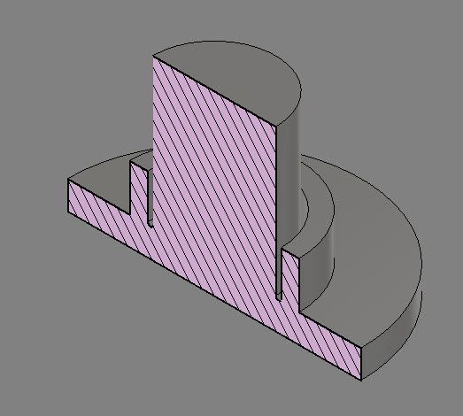

I am new to Fusion 360 and I am unable to figure out
how to do something, would anybody be able to
advise me how I could go about doing it?
I want to create a channel around the inner cyclinder that is
1.1mm wide and which extends down to level of the base
cyclinder. It is to accomodate a pipe slieving over the
inner cyclinder, so that it goes down as far as the level
of the base cyclinder. See attached images of the model.
Thanks.
Ian

aliobidi
Hi ,
is that what you meant ?
Message 4 of 19
wersy
Do you mean something like this?
Message 5 of 19

Message 7 of 19
jhackney1972
I am still guessing but this is what I think you mean.  Model is attached.
John Hackney, Retired

Message 9 of 19
ian79VDU
Yes John that is exactly what I mean.
Thanks.
Can you please explain how you did it.
Ian

wersy
Oh, seems to be the same as @jhackney1972  😉
Message 11 of 19
ian79VDU
Thanks Wersy, yes that is what I am trying to understand how to do.
Ian
Message 12 of 19
jhackney1972
Here is the Screencast showing my process.
By the way, since you are just beginning to learn Fusion 360, take my advise and limit your use of Primitives.

Now you have to ways how to do it.
My was is to make a sketch on top of the middle cylinder and get the circles by projection.
Then offset the inner circle 1,1 mm.
Then cut out to object
But you can do it as well drawing a half section and revolve all together as I did in my first attempt.
