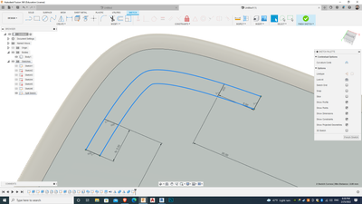

I'm trying to learn how to work with surfaces and am following along with a tutorial, but can't recreate the steps in the tutorial. Attached are: 1. the Fusion 360 model, and 2. the steps from the tutorial I'm trying (unsuccessfully) to take. Many thanks if anyone can please let me know what I'm doing wrong! (Specifically, I can't select the "edge piece" geometry to trim).

2. There are only solids in your design.
    Surface tools are not applicable to solids.

these two line must divide to have 3 sketch loop to cut and delete the two end pieces
 you should work in this environment not in solid work place

You picked a poor tutorial, the author is not clear on his instructions, I hope I interpret them correctly myself.  One thing you must understand about the Split Face command.  It must full cross the area you are going to split.  That is why, in the Screencast, I split the whole curved sketch out of the face first, then come back and do the ends.  After the first split, the end sketch lines cross the face completely.  I hope this helps.  Model up to the point of your instructions is attached.

It is generally a bad idea - In Fusion 360 - to offset splines, or projected curves that were created from splines.
The original curve is fine:
The curvature of the projected curves its completely broken:

The tutorial left out one very important step that solved my question: projecting the edge down onto the offset surface. Question: Why do we need to project the edge down onto the surface? Doesn't the surface already have an edge that we can offset?

. . . Many thanks once again for your great solution. Just a quick note, I tried your solution separately without that last Project, and it still works.
My thought is that the tutorial is a bit old and maybe the trim functionality has changed a bit since then. But even still, I don't see how it could have worked with the last Trim features taking place in the "bottom surface" as the tutorial showed. The Trim features had to have taken place in the offset surface, as your solution showed.
