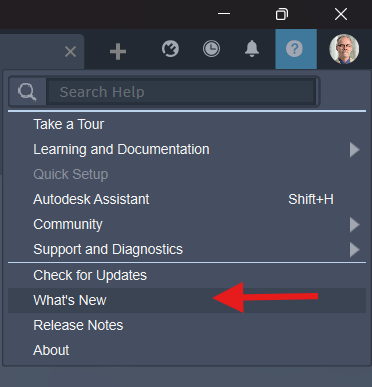

Here is another little tip:
Fusion is updated frequently. After each major update, I recommend quickly reading the "What's new" section.
