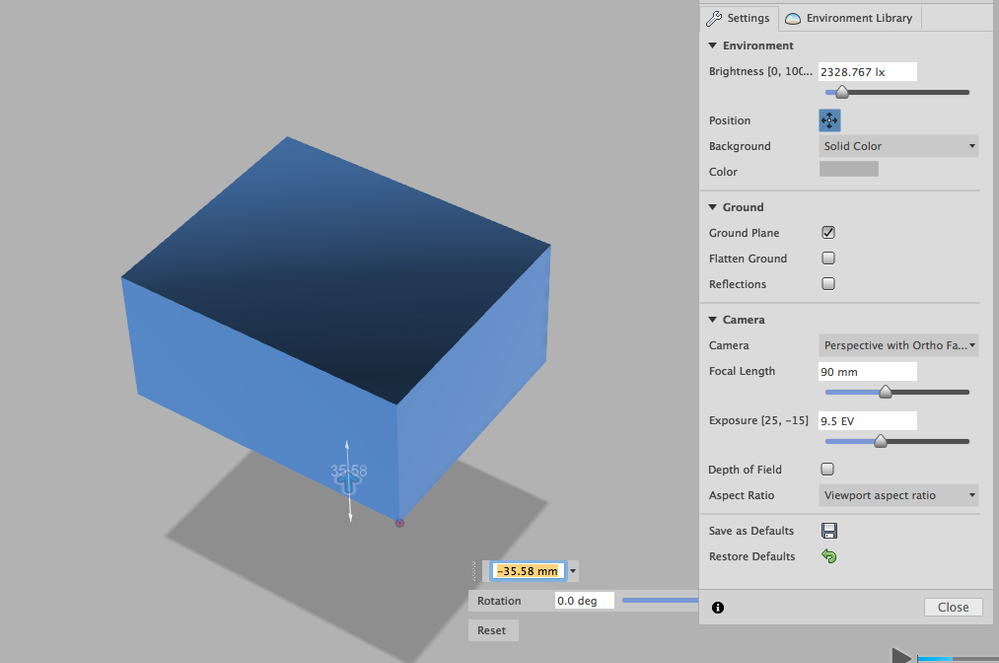

Hi @Anonymous,
Check your render settings and make sure that you have the ground plane turned on.
If the box next to Ground Plane is not checked there is nothing to project a shadow on.
Hope that helps,
Colin
