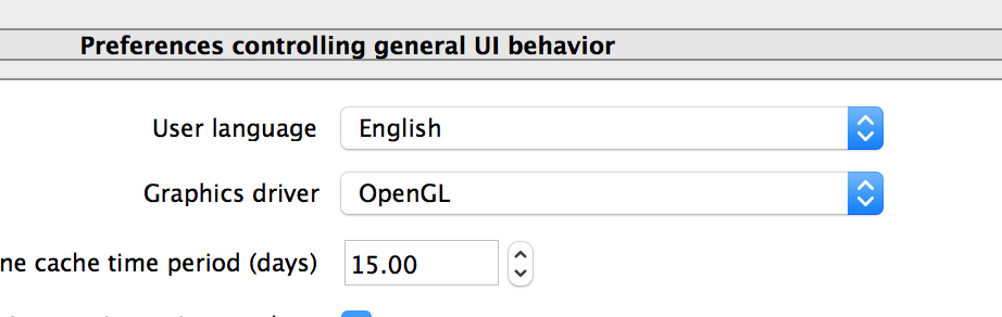

I switched graphics drivers from "Auto-Select" to "OpenGL" and this seems to have fixed the problem. When "Open GL Core Profile" is selected the problem persists.
Message 3 of 8
ddecker
Spoke too soon.
Behaved normally for a little while, then problem returned

The material is the default (steel)
The behavior seems to have resolved as I cannot replicate it today. Someone change something???

chen.xu
There has not been anything changed on Fusion side since your report. What's interesting is that when you switched to OpenGL, you got everything work well for a while and then it messed up again. If rebooting got it fixed, I guess it might be caused by a driver issue.
